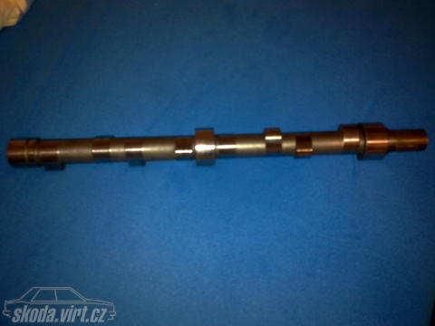

adrallyteam
5

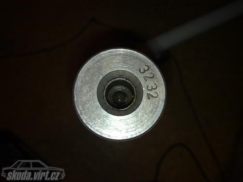

adrallyteam
4

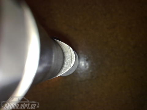

adrallyteam
3

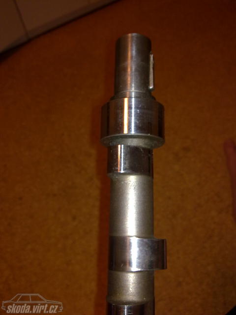

20:06:15
11.10.2011
11.10.2011
adrallyteam
1
