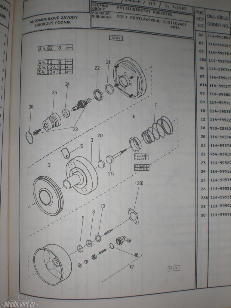

-> Christopher: I´ve bought that booster for 500 CZK (about 25 CAD). It is new, but there´s been some rusty brake cylinder mounted on it, so the top is a little bit rusty too.
Also there is missing the vacual valve.
And it is booster for older model, so one part have to be replaced before mounting the booster to newer ("M") model.
If you´d like, I can replace that part and try to get somewhere that missing valve.
If you wouldn´t, never mind - I´d put it to my spares

P.S.: I´ve got one more question - are you sure, that the wrong part is the booster? More probably it would be the suction hose leadinguder the car from the (intake piping of the) engine to the brake booster. If your Skoda has an original one, sure it will be rotten and chapped.
First try this possibility
Well, I´ll try to get the new one as soon as possible and then I´ll write here, or to your e-mail (if this skoda@skodacanada.ca is your e-mail adress).
And, by the way - don´t you, or anybody of your Canadian Škoda community, need any other spare parts? When we will ship more parts in one box, it would be more effective and economical, wouldn´t it be?

Hi Chris,
I know about one new brake booster in one shop, but it is for older model (1981).
There are some differences between new and old model of booster, the maim and the only you have to solve is the "button" (pos. 26 at the scheme).
Or I can ask some reseller, who could have a new type.
The last possibility is to refurbish your old booster with new parts - needed pos. (if damaged) - 2, 3, 8, 12, 20, 22, 23, (24, 25). Part pos. 3 you can refurbish, if it is scratched, by honing and polishing.
So, let us know, what way would you prefer
And for your easier selection - estimative price of new booster would be about 45-65 USD, parts needed for refurbishing your old one about 20 USD...
And I don´t know the taxes for shipping...
