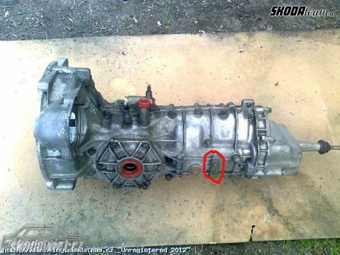

The plate I mentoined is accessible with gearbox in the car, but I'd suggest you lift the back at least a bit, otherwise it's quite cramped down there :) I've highlighted it on the attached picture.

And what -> dragon_cb_cz: wrote about the springs and balls, they are under the "oval shaped" steel plate ( skoda-katalog.eu/ekatalog -105-120/.../2632-vicko-pr uzin - pos. 19).
The plate is situated at the right side of gearbox and is fastened by two M6 screws (10 mm hexagonal head).

-> Christopher: If it won't stay in gear, there's a small oval-shaped cover plate on the side of the gearbox, under it there are two springs and balls (see here: skoda-katalog.eu/ekatalog
-105-120/.../53-zasouvaci-
ustroji-(5q) ) that hold the gear selection forks in place. Check them, it's likely that one of the springs is broken.
