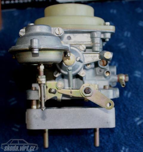

As you can see, there is no solenoid, so it could be a carb for Škoda 1203/ TAZ 1500, or maybe a substitution of an older carb for 1201/1202. But the configuration of it (dif 22/24 and vzd. 200/180) shows, that it is more likely set for 1289cc (or higher) engine...
And the throttle lever shows, that the pull bar for it would be upside...9
I do not know any Skoda, that has such throttle control...
...maybe it is not for car, but for some other machine (eg. cooling unit, generator, or fire pump engine, etc).

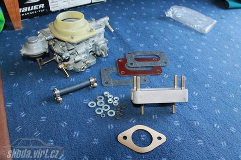

And one more / A ještě jedna:
zvětšit Jikov 32 Sedr 3256 ??? - obrázek od .Bala. vložen 08.07.2013 22:51:28

Hi! Thanks for the infromation. In the meantime it came to light that the conversion isn't fit to S100 intake manifold, because the distance between the two screws are longer, around 68mm. Here's some picture from the throttle control lever:
Ahoj! Díky za informace o pořadu. Mezitím vyšlo najevo, že převod není vhodné, aby potrubí sání S100, protože vzdálenost mezi dvěma šrouby jsou delší, kolem 68 mm. Zde je několik obraz z Páka plynu:
zvětšit Jikov 32 Sedr 3256 ??? - obrázek od .Bala. vložen 08.07.2013 22:50:24

-> .Bala.: 3255 was for TAZ 1500, so maybe it was meant as a conversion for older TAZ/S1203 cars that originally had a single barrel carb? That would fit the S100 as well, but the difusors are way too big for S100/110... So my guess is TAZ 1500/S1203 or something that uses their engine - forklift or something like that.
EDIT: Could you perhaps snap a detail of the throttle control lever? The way it was supposed to be attached to the string that comes from the throttle pedal could give us some indication.

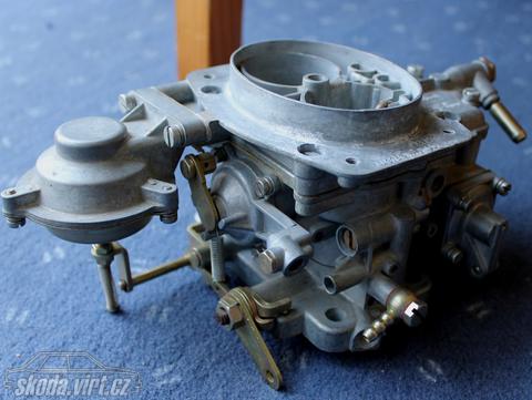

Ahoj!
Za prvé, omlouvám se za mé české, to je prelozen googlem překládat z angličtiny.
Mám Jikov 32 SEDR karburátor, který má číslo 3256. Ví někdo, jaký druh vozidla je? Tam je konverzní set pro carb, myslím, že umožňuje instalaci do potrubí sání S100. Hledal jsem hodně v internetu, ale nenašel žádnou informaci o tomto JIKOV.
Některé další informace:
číslo dílu: 443 751 3256 00 UA
komory: 32/32
V. difuzér: 22/24
Vzdušníky: 200/180
Nějaké nápady?
Hi everybody! I got a Jikov 32 SEDR carb which has the number 3256. Does anybody know what kind of vehicle is it for? There is a conversion set for the carb, I think it makes possible istallation onto S100 intake manifold. I've searched a lot in internet, but haven't found any information about this Jikov. Any ideas?
zvětšit Jikov 32 Sedr 3256 ??? - obrázek od .Bala. vložen 08.07.2013 15:36:30
